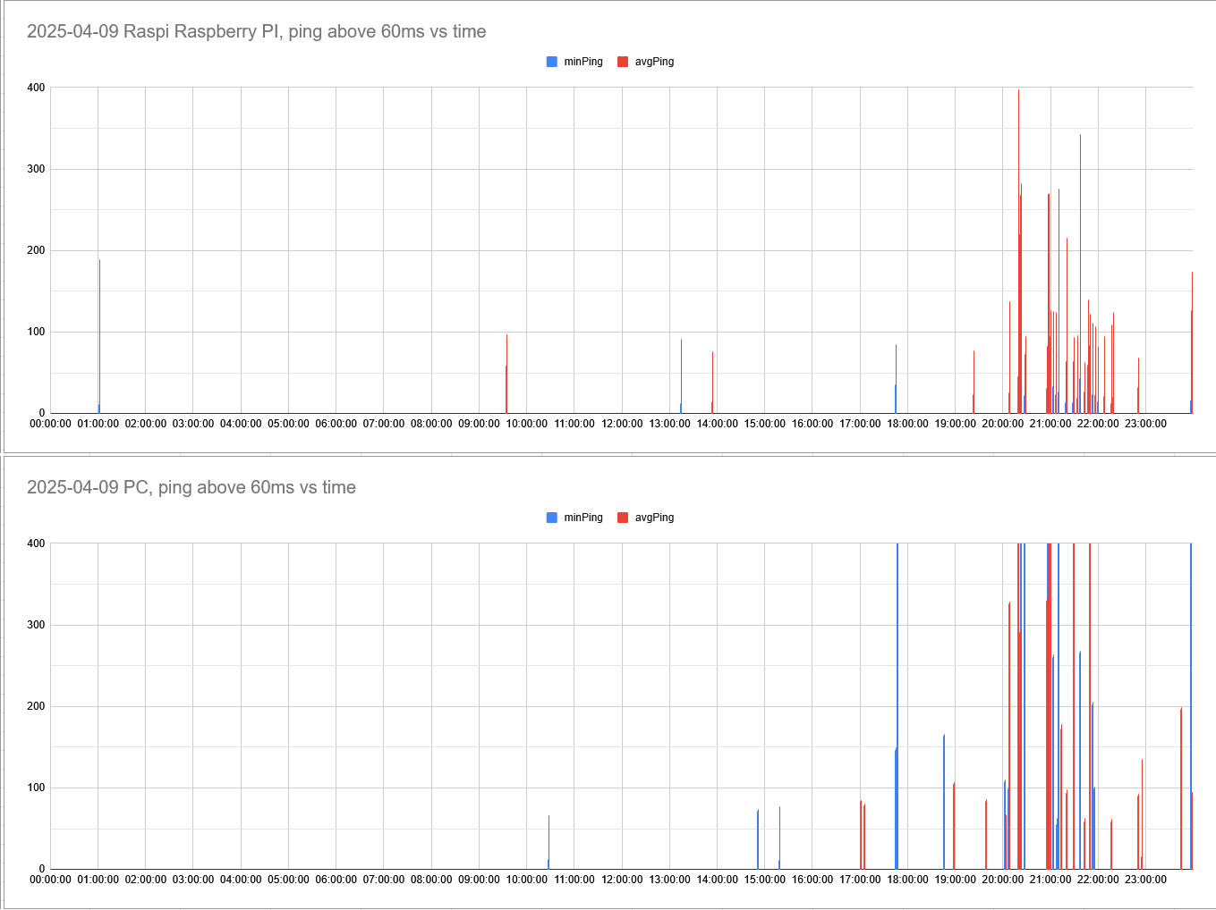

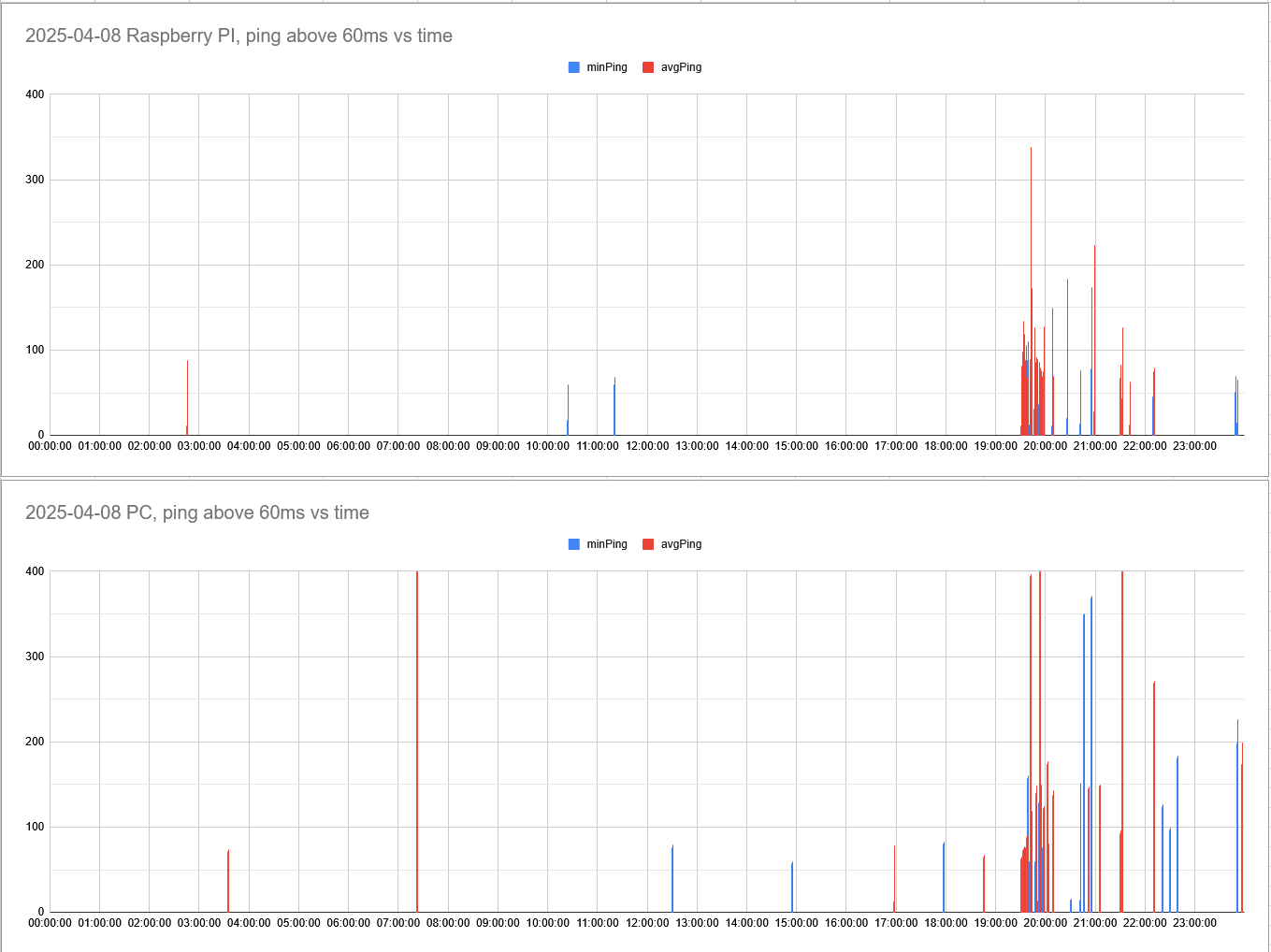

    A technician came to my house on 04.04.2025 and gave me a connect box 3 that was configured in modem mode. We decided to try it for a week to see if anything would change. On my side I developed an app to track and log my ping automatically so I could see if there was a pattern during the day.
    I tracked both the ping on the computer connected to this new modem and the ping on a raspberry pi inside my usual network.
    Every second I monitored weather data, min ping, average ping, max ping and lost packets. The pings were done on the following servers:
    • 8.8.8.8 (Google’s DNS)
    • 80-218-176-1.dclient.hispeed.ch (Sunrise)
    • 217-168-52-201.static.cablecom.ch (Sunrise)
    • zur01pe20.eth-trunk0.bb.sunrise.net (Sunrise)
    • 195.141.239.98 (Sunrise)
    The following charts show the results (I plotted average and max ping, if the ping exceeds 60ms (the usual value is under 20ms for all servers when there are no issues).
    The results during 2 days seems to show that the issue always happen around the same time. This makes me think that the network is in fact overloaded between ~19h30 and ~23h00. It could be an issue with one of the “boxes in the street” in my village since my friend does not have the same issues at the same time (he has a few issues sometimes but it doesn’t affect him as much as me).
    The reason the PC has more spikes is because the new modem does not have the filter installed, which causes a bit more instabilities. However, the big spikes affect both devices.

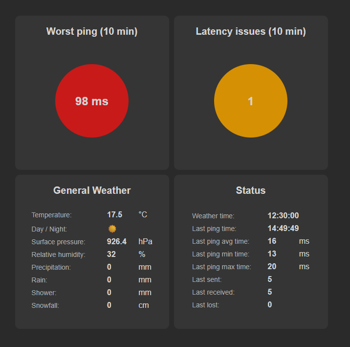

    Also I verified by making a page that shows the status in real time, the spikes in the chart indeed corresponds to when I notice lag in game / in voice chats
