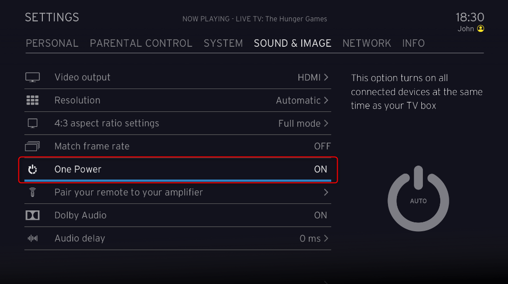

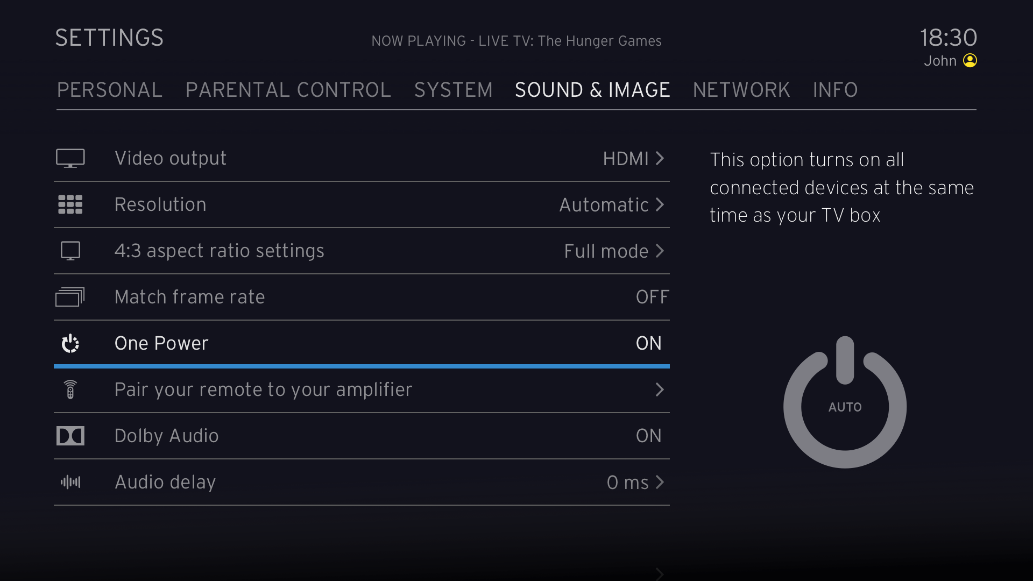

I’m currently doing some testing to see if it’s an HDMI handshaking issue, by turning the devices on in different orders to see if that helps.
Edit: Nope, can’t get it to show. Turning the box on turns on my TV and AVR automatically (and it’s not IR, it’s definitely HDMI-CEC). Also, if they are both already turned on, the TV detects the HDMI-CEC input correctly.
