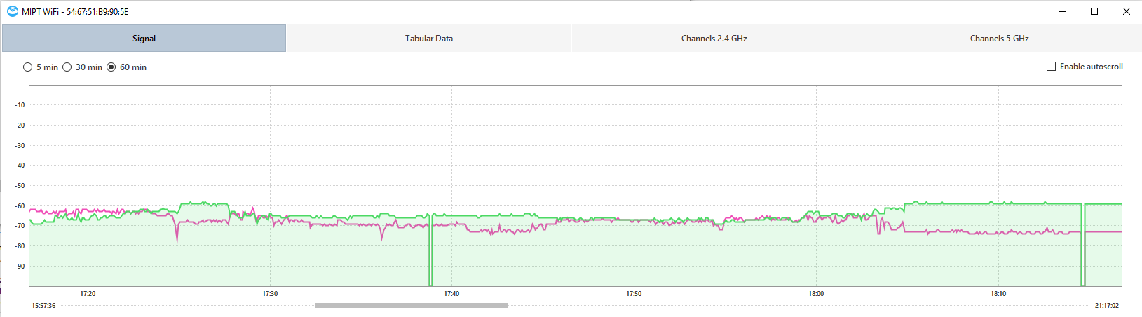

Many thanks for coming back. I will try to follow your reccomendations, however considering that both chanels (2.4 GHz and 5.0 GHz) are dropping at the same time, I'm struggling to see how it might help. The problem is not in strength of signal, but in its stability.
Based on your comment I understood that the problem arises at the point of WiFi router. I observed today again significant drops in the signal (image attached - orange stands for 5.0 GHz, green for 2.4 GHz). I tried to reboot the router, but it doesn't help in a long run, since drops continue to appear.
