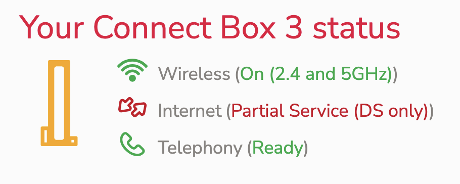

Every few minutes recently, my box pops up a CS2004 “connection lost / check cables” message for maybe one second.
I logged this under Sunrise Internet as my box, which still occasionally flashes red (power supply green light is fine) is now permanently showing a “Partial Service (DS only)” message which I assume is related.
I’ve checked and reseated all cabling for both the Connect Box and TV box. Too much of a coincidence that both are impacted. They’re both plugged directly into a 2-hole wall socket.
A couple of months ago I had an engineer over who replaced the modem, which did improve things. I no longer lose internet and in fact it seems fine despite the Partial Service message.
