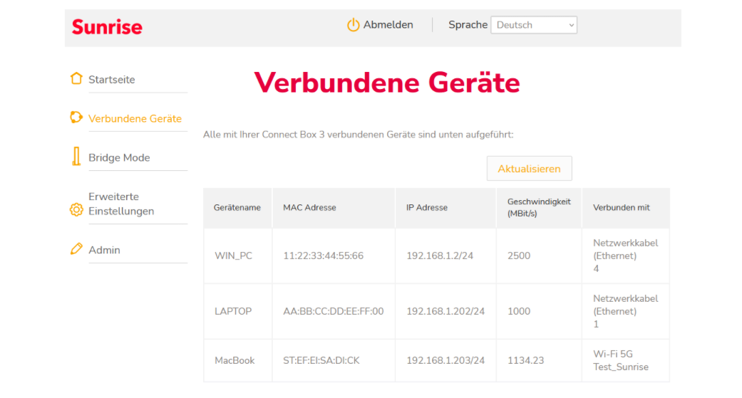

Please sign on to your Connect Box it should show you how fast the connection speed is. Here’s an example how it should look like:
If your TV only has a 100Mbit/s NIC the Connect Box will show 100. The Wifi on the TV might be faster then the LAN port.

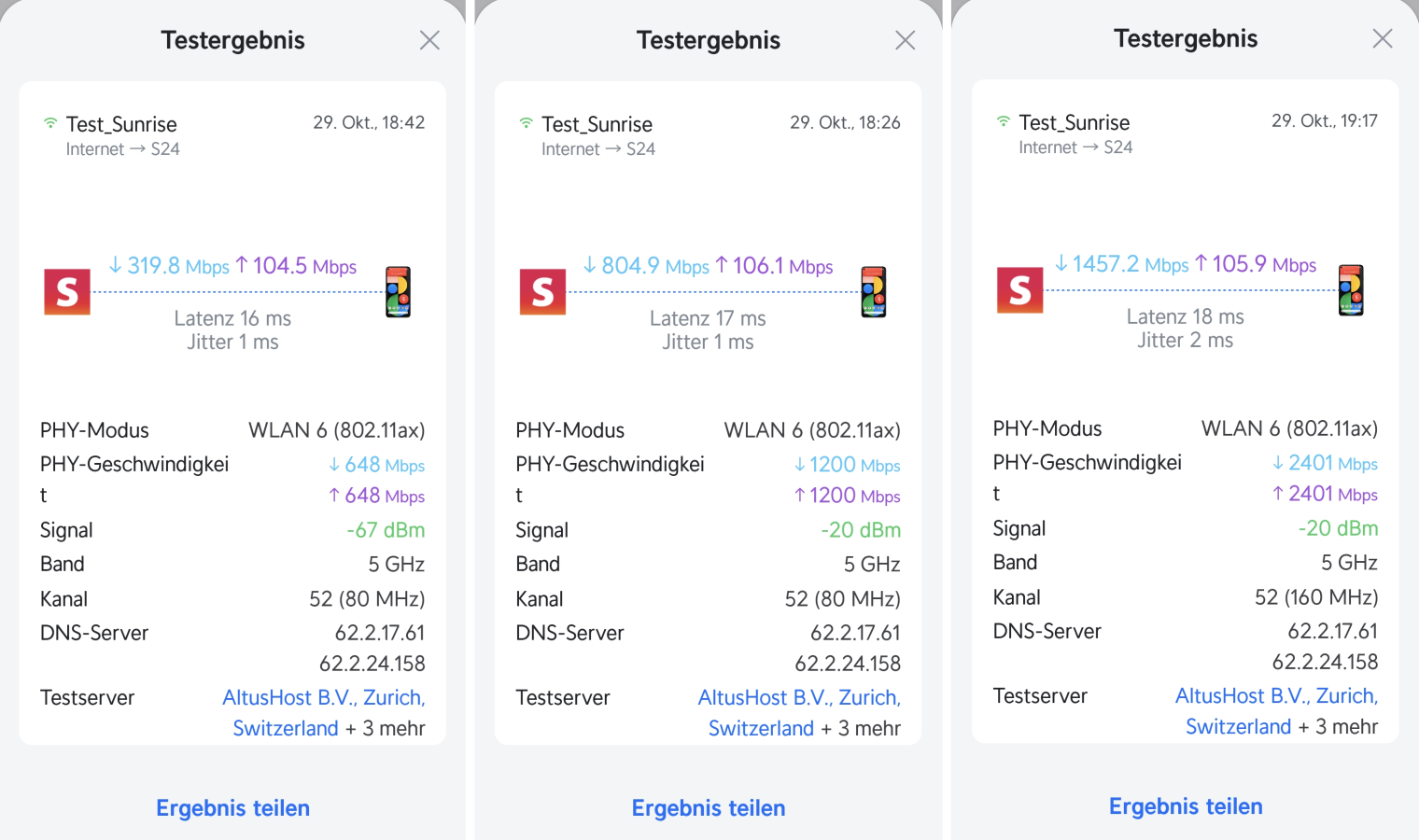

Your Wifi-test results are good. They are limited by the wifi-signal and not so much by the internet-speed. I recommend using wifiman by Ubiquiti to test wifi-connections. It also includes wifi speeds.
The app is freeware and works without the need of Ubiquiti hardware.
This tests where made in different locations and with different settings on a Connect Box 3 HFC (2.5Gbit/s down / 100Mbit/s up).
