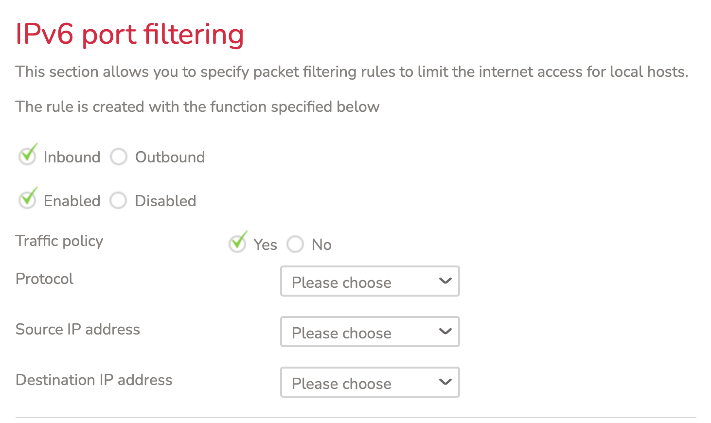

It seems to me that the router is not allowing for listening on IPv4 port 22 via ethernet. When I log onto the router I see that the only option for port filtering available is for IPv6.
