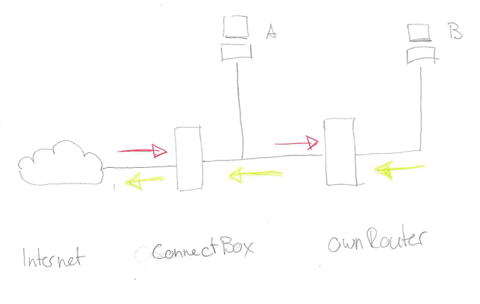

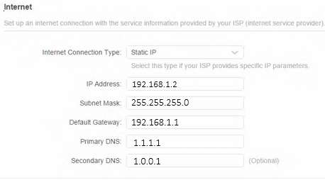

Using DMZ to “bridge” the TP-Link to the Connect Box:
Since Bridge Mode is unavailable, this seems like the best alternative.
My concern is whether it will impact performance or add latency.
Does anyone have experience with this setup?
