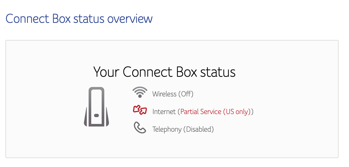

I’m getting upload speeds of <1Mbps with my Connect box running in Modem mode and only one client connected to it via Ethernet.
The status page of the modem also shows me partial service
On the upload details I see 6 bonded channels:
Item Status Comments
Acquired Downstream Channel(Hz) 658000000 Locked
Ranged Upstream Channel(Hz) 51100000 Ranged
Provisioning State Online Operational
Upstream bonded channels
Channel Frequency (Hz) Power (dBmV) Symbol Rate (ksps) Modulation Channel ID
1 51100000 46 5.120 64qam 3
2 30700000 45 5.120 64qam 6
3 37300000 46 5.120 64qam 5
4 44200000 46 5.120 64qam 4
5 63300000 44 2.560 64qam 1
6 57900000 46 5.120 64qam 2
Channel Channel Type T1 Timeouts T2 Timeouts T3 Timeouts T4 Timeouts
1 2.0 0 0 11 0
2 2.0 0 0 7 0
3 2.0 0 0 11 0
4 2.0 0 0 6 0
5 2.0 0 0 16 0
6 2.0 0 0 11 0
Does my modem have issues bonding upstream channels?
