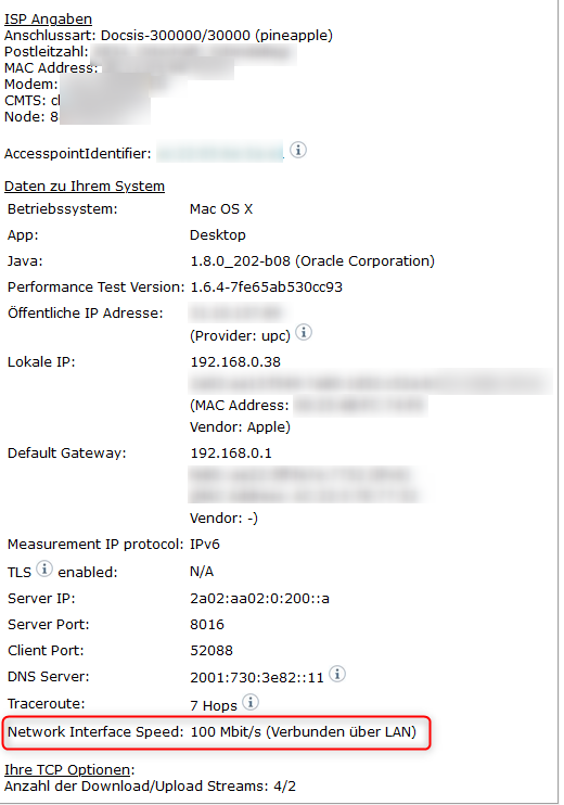

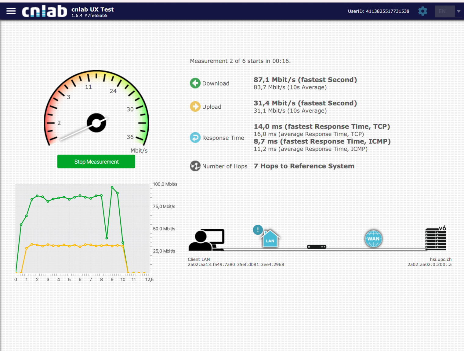

MBal My internet speed went down from 300 Mbit/s to below 100. Any ideas about the remedy? I did the test, few resets and removed devices; nothing worked. Thx
Daniele_Sunrise MBal Welcome to the UPC Community! Please perform a speed test according to the following instructions. Afterwards, please report back here with the CNLAB UID. Greetings Daniele
TheSven The speed shown is typicall when then Ethernet connection is just 100Mbit. Can you verify that the testing device really has a GigaBit connection to the ConnectBox? Maybe you have a faulty cable.
Daniele_Sunrise MBal @TheSven has written it correctly. A component on your Mac or in the network slows everything down to 100mbit. Please find the source and make sure everything is connected to 1 Gbit. Greetings Daniele
